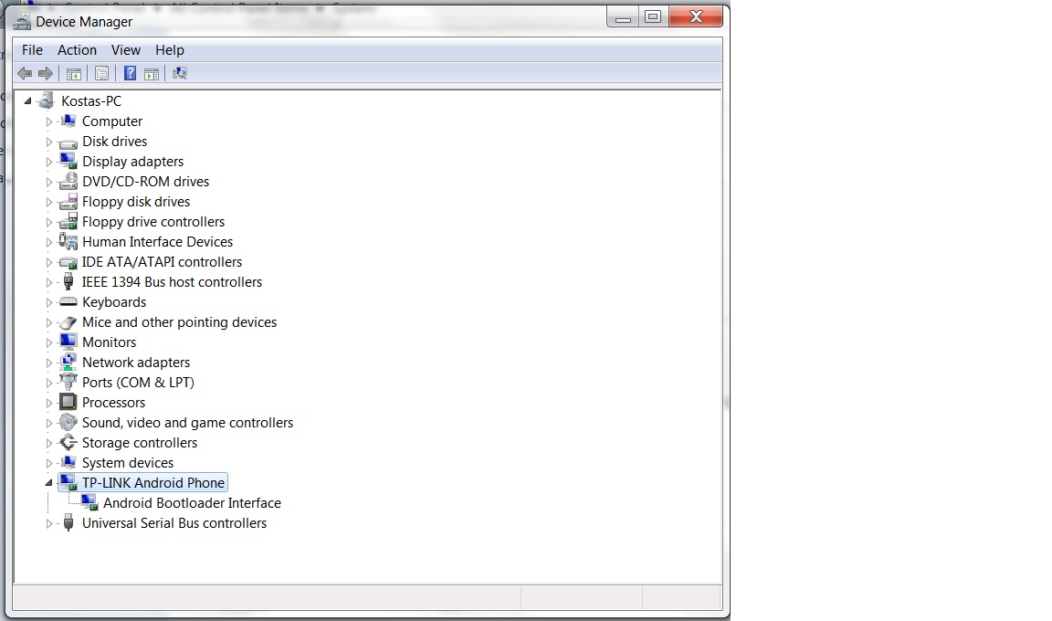

1. Open Device Manager and Phone will be detected as QHUSB_BULK under the Com Ports section.
Right Click and choose Update Drivers.
Note: - Driver Signature Enforcement: It's recommended to disable. Reboot your PC in Advanced Mode and Choose Disable Driver Signature.
Disable Driver Signature Enforcement 7/8/10-In Windows 64-Bit
2. Choose Browse My Computer for Driver Software
3. Choose the Path of Xiaomi Folder. Of users will Most find it like RatingsPage.aspx.
Note: - If Folder does not exist, MI Install Flash (Link below) first.
Win 64 bit C: \ Program Files (x86) \ Xiaomi \ MiPhone \ Qualcomm \ Driver
Win 32 bit C: \ Program Files \ Xiaomi \ MiPhone \ Qualcomm \ Driver
4. Choose Install this Driver Software anyway.
5. Wait till driver installation successful.
6. The driver will be installed Sucessfully and you can see added in Ports as Qualcomm HS-USB.

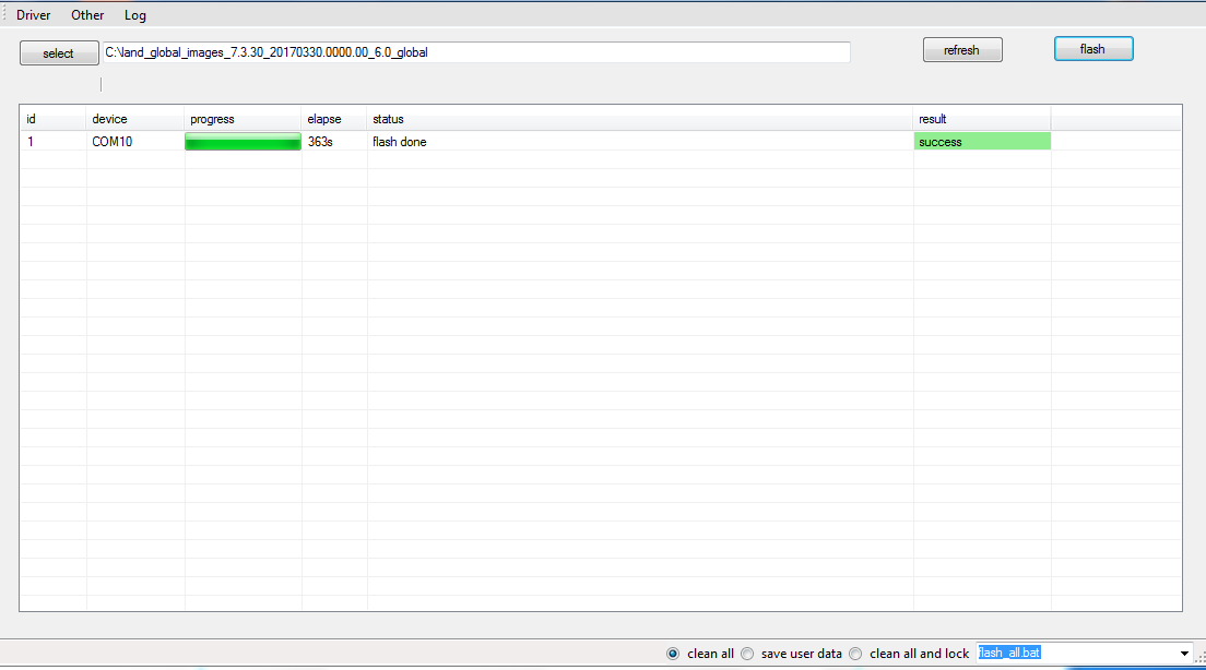

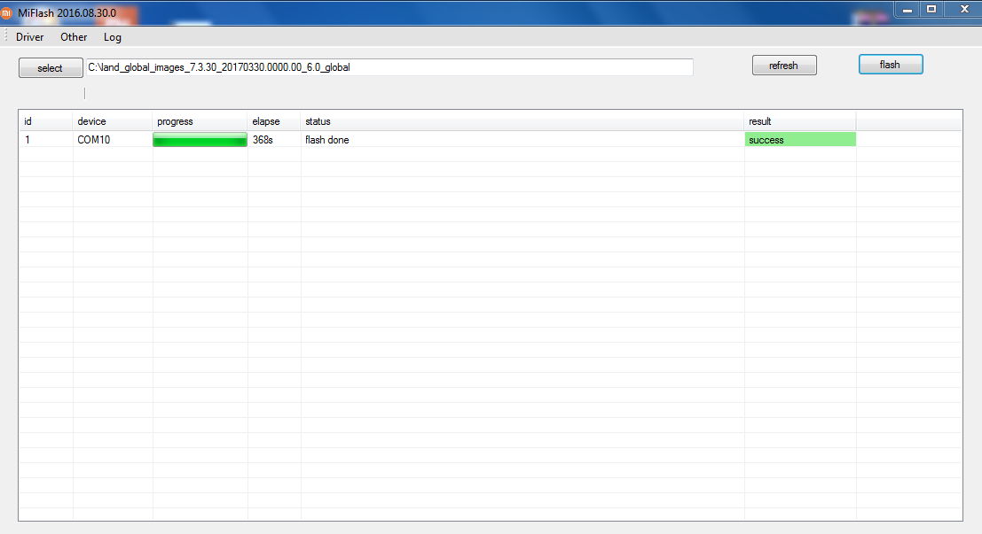

3. Once installation is complete, Run MiFlash Beta application
4. Click on browse
5. Select ROM folder from Desktop (From the location where ROM is saved)
Note: -The path of the ROM folder Should be like "C: \\ MIUI" Not "C: \ MIUI \ images"
The MIUI Rom folder should Contain the following files
6. Press Refresh button to see you device in flashing tool.
After pressing refresh button you will see connected device (COM 3 or COM 4)
Choose Flash_all option.
8. Click on Flash and it will start process
9. Once flashing process completes
The cable rubber and Remove keep Power Button pressed until it Vibrates and shows MI LOGO.
The Device will start, wait till completion, it can take up to 10 Minutes.
