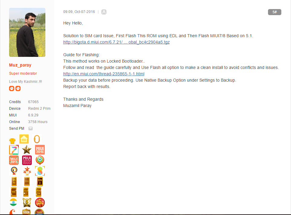

    • Δεν το δοκίμασα και ούτε θα το δοκιμάσω μάλλον......Βαρέθηκα..... Για όποιον άλλο έχει το κουράγιο.....
      Hey Hello,
      Solution to SIM card Issue, First Flash This ROM using EDL and Then Flash MIUI7/8 Based on 5.1.
      http://bigota.d.miui.com/6.7.21/ ... obal_bc4c2904a5.tgz
      Guide for Flashing:
      This method works on Locked Bootloader..
      Follow and read the guide carefully and Use Flash all option to make a clean install to avoid conflicts and issues.
      en.miui.com/thread-235865-1-1.html
      Backup your data before proceeding. Use Native Backup Option under Settings to Backup.
      Report back with results.
      Thanks and Regards
      Muzamil Paray
