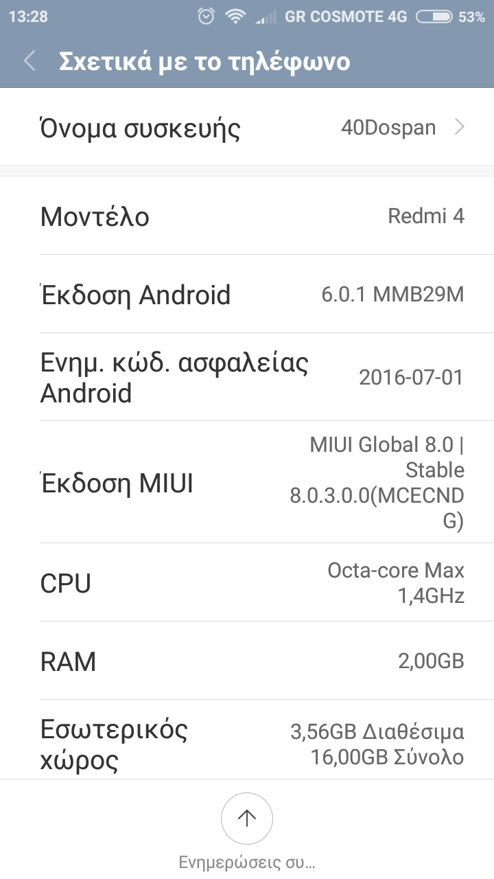

Greetings MIUI Lovers and Redmi 4/Prime/4A Users,
Steps for Flashing/Unbrick Redmi 4/Prime/4A: (This can be used to flash from China Rom to Global Rom, or Tampered Rom to Original Rom)

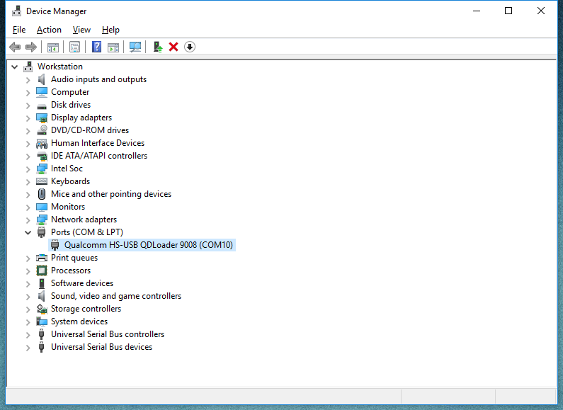

On your PC do these next steps:

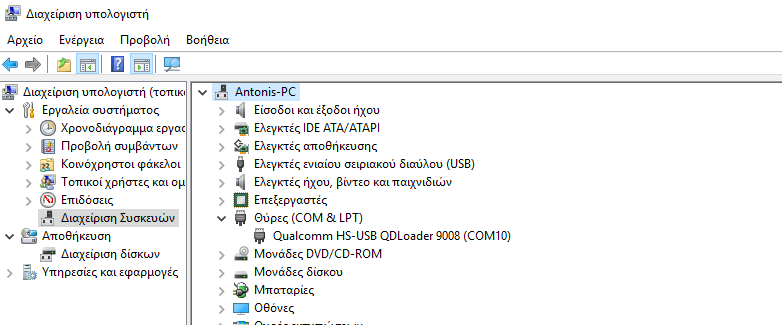

1. Open Device Manager and Phone will be detected as QHUSB_BULK under the Com Ports section.
Right Click and choose Update Drivers.
Note : - Driver Signature Enforcement: It's recommended to disable. Reboot your PC in Advanced Mode and Choose Disable Driver Signature.
Follow this thread (Credits to @feds64 ) Disable Driver Signature Enforcement in Windows 7/8/10 64-Bit
2. Choose Browse My Computer for Driver Software
3. Choose the Path of Xiaomi Folder. Most of users will find it like this.
Note:- If Folder does not exist , Install MI Flash (Link below) first.
Win 64 bit C: \ Program Files (x86) \ Xiaomi \ MiPhone \ Qualcomm \ Driver
Win 32 bit C: \ Program Files \ Xiaomi \ MiPhone \ Qualcomm \ Driver
4. Choose Install this Driver Software anyway.
5. Wait till driver installation successful.
6. The driver will be installed Sucessfully and you can see added in Ports as Qualcomm HS-USB.

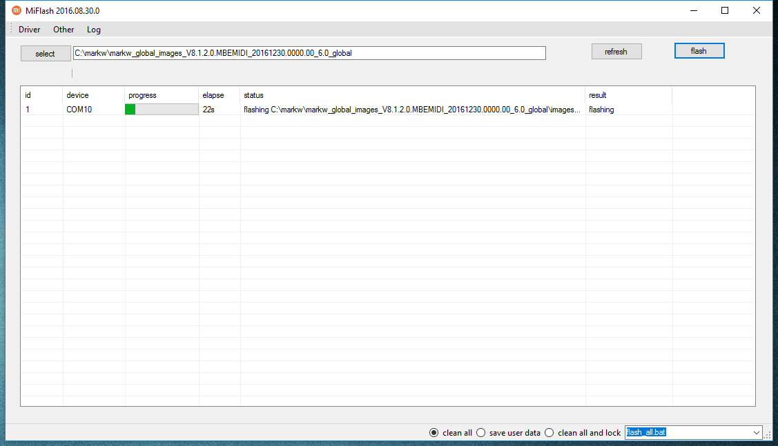

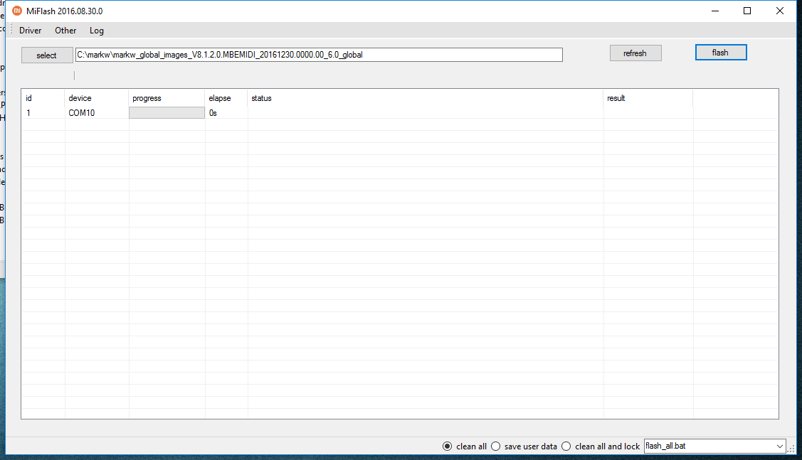

3. Once installation is complete, Run MiFlash application

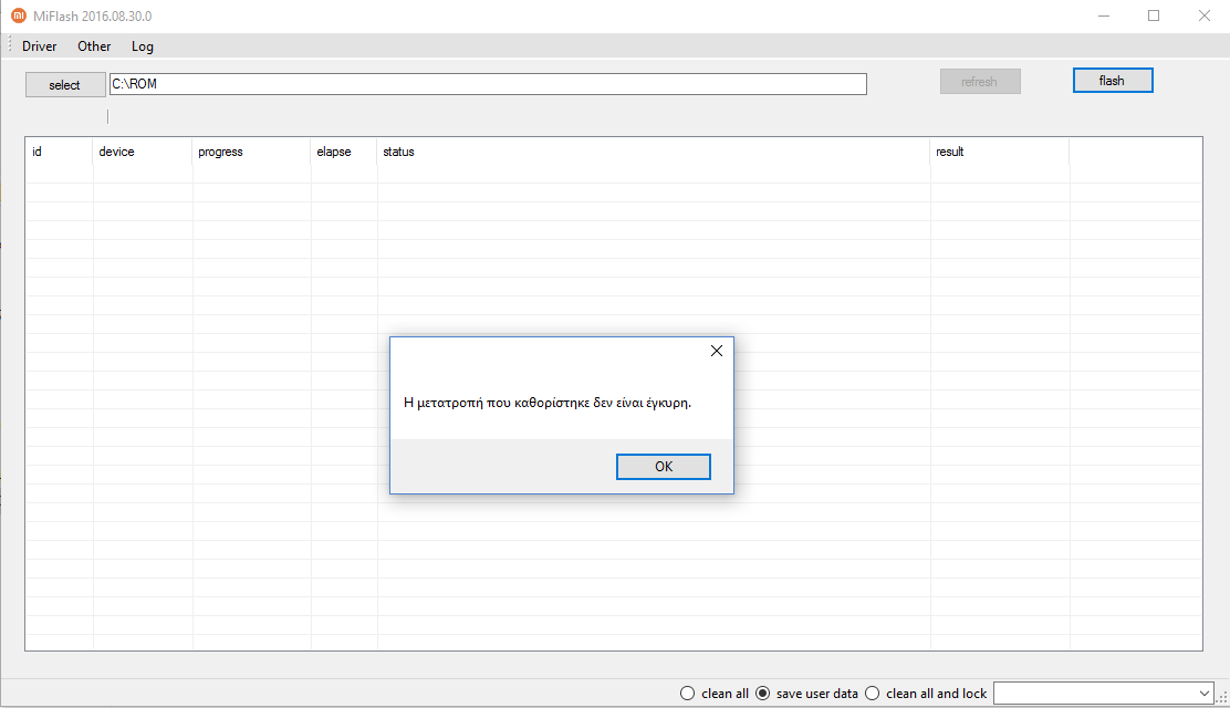

4. Click on browse
5. Select ROM folder from Desktop(From the location where ROM is saved)

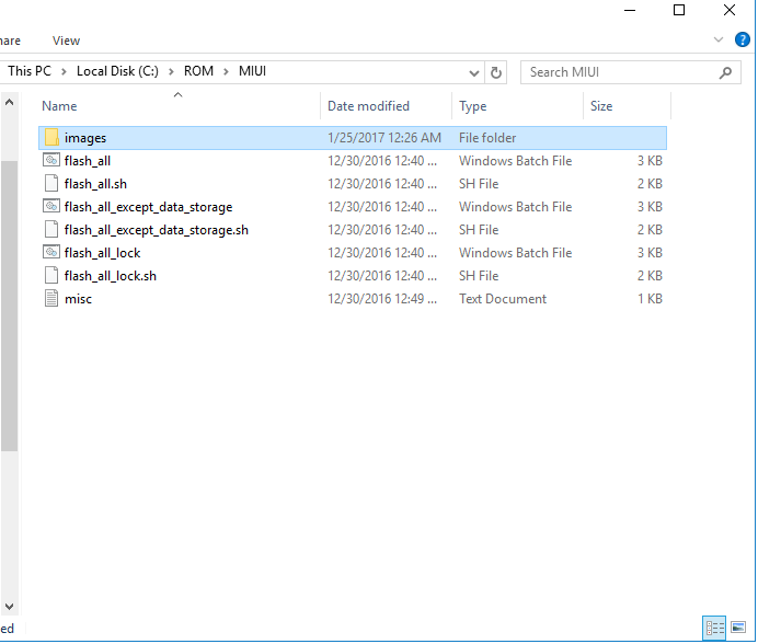

Note: -The path of the ROM folder Should be like "C:\\MIUI" Not "C:\MIUI\images"
The MIUI Rom folder should Contain the following files
6. Press Refresh button to see you device in flashing tool.
After pressing refresh button you will see connected device (COM 5) in my PC
Choose Flash_all option.
8. Click on Flash and it will start process

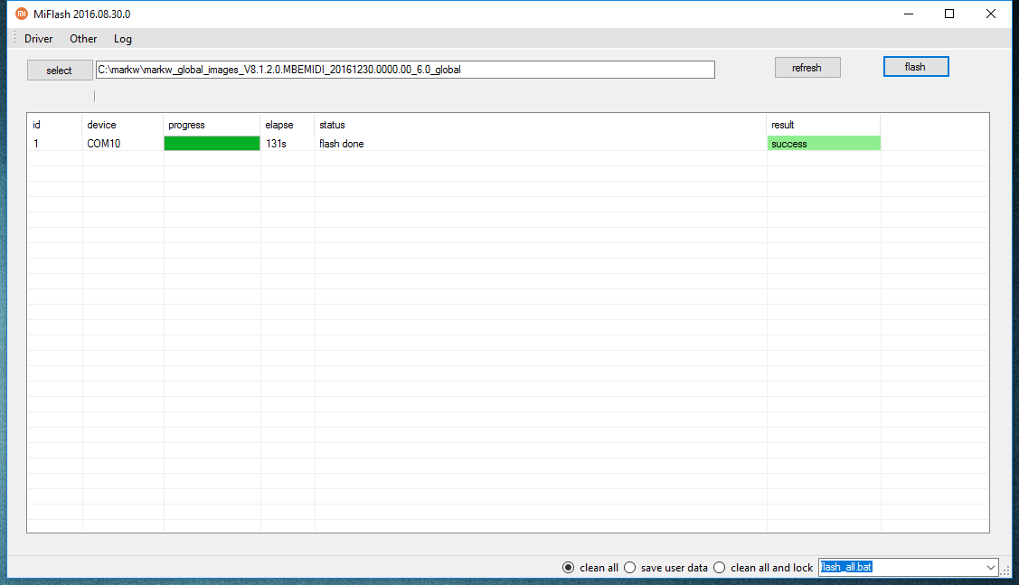

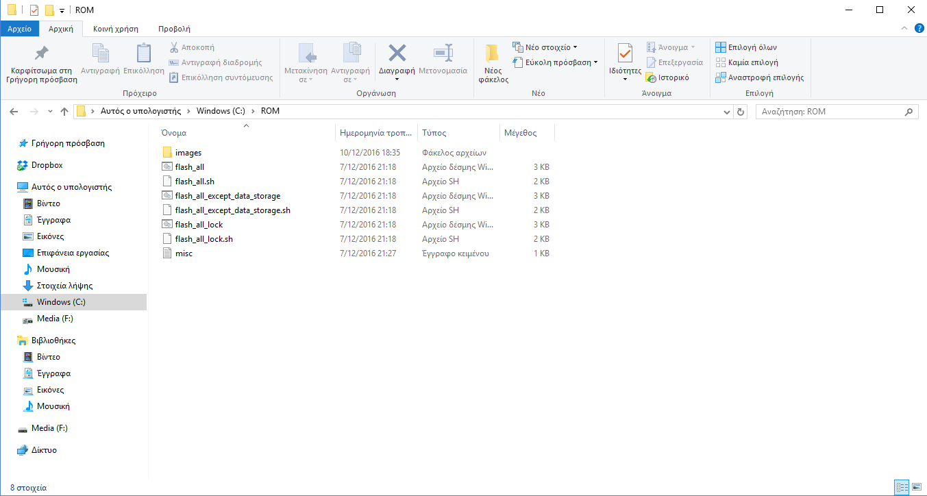

9. Once flashing process completes
Remove the cable and keep Power Button pressed until it Vibrates.
The Device will start, wait till completion , it can take up to 10 Minutes.
