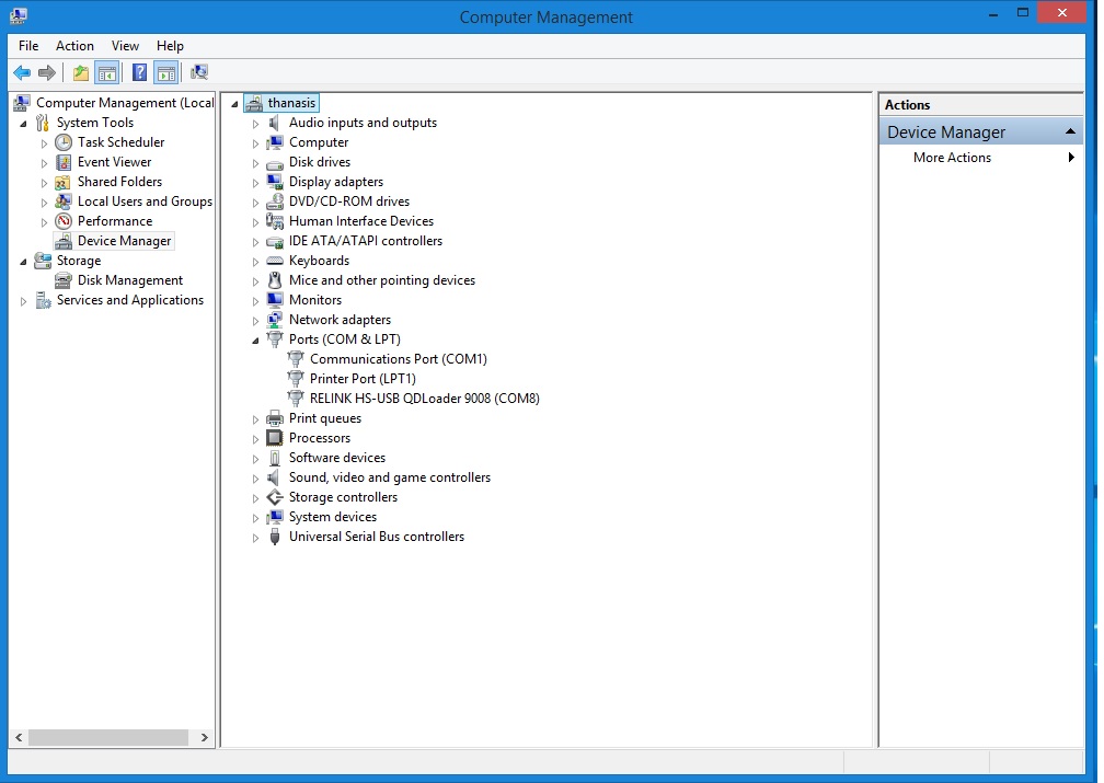

On your PC do these next steps:
1. Open Device Manager and Phone will be detected as QHUSB_BULK under the Com Ports section.
Right Click and choose Update Drivers.
Note : - Driver Signature Enforcement: It's recommended to disable. Reboot your PC in Advanced Mode and Choose Disable Driver Signature.
Follow this thread (Credits to @feds64 ) Disable Driver Signature Enforcement in Windows 7/8/10 64-Bit
2. Choose Browse My Computer for Driver Software
3. Choose the Path of Xiaomi Folder. Most of users will find it like this.
Note:- If Folder does not exist , Install MI Flash (Link below) first.
Win 64 bit C: \ Program Files (x86) \ Xiaomi \ MiPhone \ Qualcomm \ Driver
Win 32 bit C: \ Program Files \ Xiaomi \ MiPhone \ Qualcomm \ Driver
4. Choose Install this Driver Software anyway.
5. Wait till driver installation successful.
6. The driver will be installed Sucessfully and you can see added in Ports as Qualcomm HS-USB.
