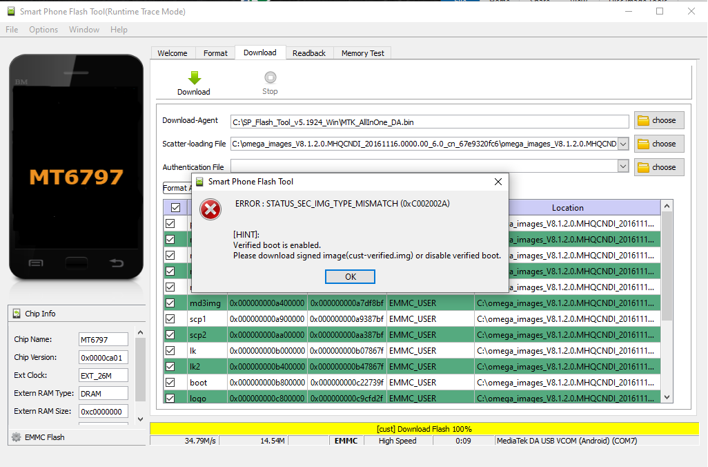

Επειδή είναι MTK από ότι κατάλαβα, το command είναι fastboot getvar all και παίρνω το παρακάτω:
PS C:\adb> fastboot getvar all
(bootloader) max-download-size: 0x8000000
(bootloader) partition-size:flashinfo: 1000000
(bootloader) partition-type:flashinfo: raw data
(bootloader) partition-size:otp: 2b00000
(bootloader) partition-type:otp: raw data
(bootloader) partition-size:userdata: 32000000
(bootloader) partition-type:userdata: ext4
(bootloader) partition-size:cache: 1b000000
(bootloader) partition-type:cache: ext4
(bootloader) partition-size:system: 9ffff000
(bootloader) partition-type:system: ext4
(bootloader) partition-size:cust: 20601000
(bootloader) partition-type:cust: raw data
(bootloader) partition-size:keystore: 800000
(bootloader) partition-type:keystore: raw data
(bootloader) partition-size:tee2: 500000
(bootloader) partition-type:tee2: raw data
(bootloader) partition-size:tee1: 500000
(bootloader) partition-type:tee1: raw data
(bootloader) partition-size:logo: 800000
(bootloader) partition-type:logo: raw data
(bootloader) partition-size:boot: 1000000
(bootloader) partition-type:boot: raw data
(bootloader) partition-size:lk2: 400000
(bootloader) partition-type:lk2: raw data
(bootloader) partition-size:lk: 400000
(bootloader) partition-type:lk: raw data
(bootloader) partition-size:nvram: 500000
(bootloader) partition-type:nvram: raw data
(bootloader) partition-size:scp2: 100000
(bootloader) partition-type:scp2: raw data
(bootloader) partition-size:scp1: 100000
(bootloader) partition-type:scp1: raw data
(bootloader) partition-size:md3img: 500000
(bootloader) partition-type:md3img: raw data
(bootloader) partition-size:md1arm7: 300000
(bootloader) partition-type:md1arm7: raw data
(bootloader) partition-size:md1dsp: 400000
(bootloader) partition-type:md1dsp: raw data
(bootloader) partition-size:md1img: 1800000
(bootloader) partition-type:md1img: raw data
(bootloader) partition-size:proinfo: 300000
(bootloader) partition-type:proinfo: raw data
(bootloader) partition-size:oemkeystore: 200000
(bootloader) partition-type:oemkeystore: raw data
(bootloader) partition-size:seccfg: 800000
(bootloader) partition-type:seccfg: raw data
(bootloader) partition-size:protect2: d78000
(bootloader) partition-type:protect2: ext4
(bootloader) partition-size:protect1: 800000
(bootloader) partition-type:protect1: ext4
(bootloader) partition-size:metadata: 2000000
(bootloader) partition-type:metadata: raw data
(bootloader) partition-size:nvdata: 2000000
(bootloader) partition-type:nvdata: ext4
(bootloader) partition-size:nvcfg: 800000
(bootloader) partition-type:nvcfg: ext4
(bootloader) partition-size:expdb: a00000
(bootloader) partition-type:expdb: raw data
(bootloader) partition-size:para: 80000
(bootloader) partition-type:para: raw data
(bootloader) partition-size:recovery: 1000000
(bootloader) partition-type:recovery: raw data
(bootloader) partition-size:preloader: 40000
(bootloader) partition-type:preloader: raw data
(bootloader) off-mode-charge: 1
(bootloader) warranty: yes
(bootloader) unlocked: no
(bootloader) secure: yes
(bootloader) kernel: lk
(bootloader) product: omega
(bootloader) version-preloader:
(bootloader) version: 0.5
all: Done!!
finished. total time: 0.160s -

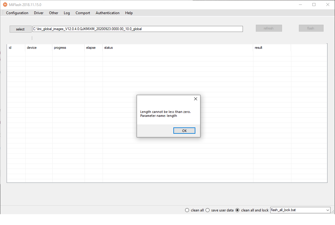

τι ειναι αυτο? το βγαζει οταν ανοιγεις το Miflash?
τελευταια εκδοση εχεις? το τρεχεις με δικαιωματα διαχειριστη? το εχεις σε φακελο στο c:\ και οχι καπου με ελληνικους χαρακτηρες κτλ?Δημοκρατία είναι 4 λύκοι και 1 πρόβατο να ψηφίζουν για φαγητό... -
Τα mediatek αν δεν κανω λαθος μονο με το SP FLASH TOOL κάνουν δουλειά.
