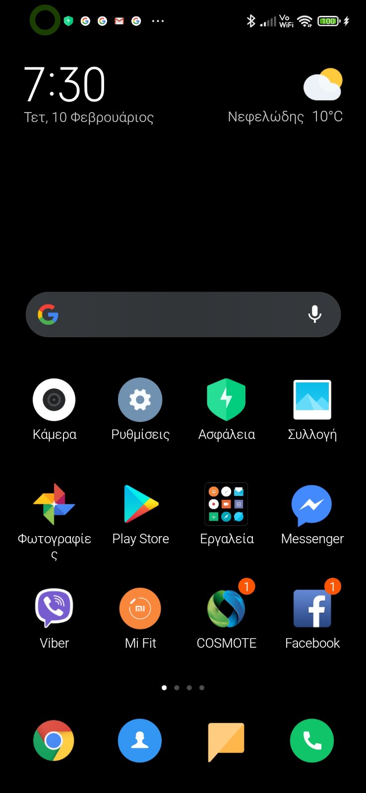

Both VoLTE and VoWiFi are working great on my Mi10Pro.
Open Modem test tools by using *#*#663368378#*#* code in dialer >
Open MBN config loading and activing tool > select mbn_eea.txt for SW
MBN > tap on validate > wait some secs for update.
See attached screenshot
